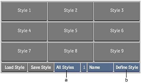

To access the Styles menu, click the Styles button in the Text menu.
(a) Style Mode box  (b) Style Option box  
Keyboard shortcuts Ctrl+Shift and F1 to F9 can be used to select the above buttons.
