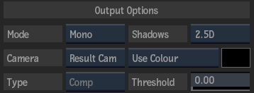

Notice that in the Action Output menu's Comp box for the Comp output, Use Colour is selected, since you entered Action with Use Back disabled.
Since Action as a Timeline FX is limited to Comp and Matte outputs, in this case you are creating a fill and alpha to then allow the Comp node to blend the Action result with the background. When you return to the timeline, you can change any blending settings in the Comp node menu.

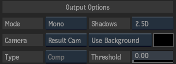

Notice that in the Action Output menu's Comp box for the Comp output, Use Background is selected, since you entered Action with Use Back enabled.
In this case, when you return to the timeline, you are sending the complete result, so there is no need to use the Comp node at the timeline level.
