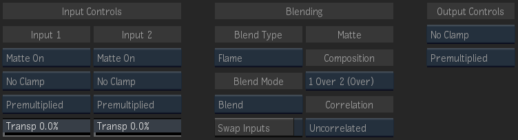

To see the full Comp menu, click the Editor button.
Input Settings
Note: Input Front and Input Back settings are identical.
Matte box
Select how the matte is used when blending.
Clamping box
Select a clamping option for colour and luminance values on input in the 16-bit floating point rendering pipeline.
Premultiplication box
Select whether the colour values in the input are premultiplied by the matte or not.
Transparency field
Displays the transparency value. Editable.
Blending Settings
Blend Type box
Select whether to use Flame or Photoshop blend modes.
Blend Mode box
Select how the front and back inputs are composited. The available list of modes depends on the selection in the Blend Type box.
Swap Inputs button
Enable to switch the rendering order of the inputs.
Blend Matte Settings
Composition box
Select how the input mattes are combined.
Correlation box
Select whether the mattes are related to each other. For example, select Correlated if the mattes are from different, but continuous parts on the same object.
Output Controls Settings
Clamp Render box
Select a clamping option for colour and luminance values on output in the 16-bit floating point rendering pipeline.
Pre-multiplication box
Select whether the colour values in the output are pre-multiplied or not.
