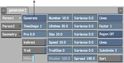

The following properties in the Particle Generator Param1 menu affect the particle stream.
(a) Stream Type box  
Stream Type box
Select whether the particle stream will Generate or Explode.
TimeSteps field
Displays the time simulation of the Generator per frame. By default, Timestep is set to 1, which means that time simulation is once per frame. Editable.
When Timestep is set to 2, the position of each particle is calculated once between frames. Any change in speed or position caused by manipulators or bouncers is applied between frames. When Timestep is set to 3, the position of each particle is calculated twice between frames. The greater the timestep value, the longer it takes to process.

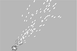

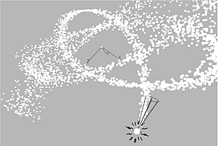

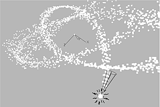

Typically, you use Timestep with a particle manipulator or bouncer on a particle stream. In the following example, the same particle settings and manipulator (AccPoint) are used. Only the timestep values are different. The particle stream on the left uses a timestep of 1 while the stream on the right uses a timestep of 6.
In the following figure, notice the particle stream on the right is more accurate.

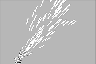

Shutter field
Displays the length of the tail for lines, cones, and quads. Shutter is expressed as a percentage. At 100%, the tail’s length is the same as the head (Size field). At 400%, the tail’s length is four times the size of the head. Editable.
Shutter at 100%
Shutter at 400%
