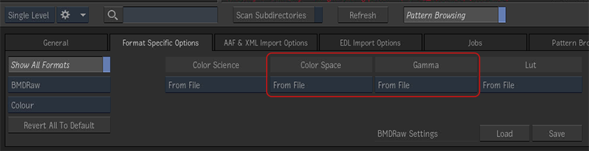

The default Tagged Colour Space is BMD Film/WideGamut Gen5. You specify a different colour space with Format Specific Options
BMDRaw
Colour where you set the Colour Space and Gamma to define the tagged colour space to use in Flame according to the previous table.
Support for DaVinci Wide Gamut Intermediate Colour Space
DaVinci Wide Gamut Intermediate colour space is now available for Blackmagic Design RAW files.
To import .braw clips set to DaVinci Wide Gamut Intermediate:
- In MediaHub, openFormat Specific Options
BMDRaw
Colour. - Set:
- Colour Space: DaVinci Wide Gamut
- Gamma Curve: DaVinci Intermediate
