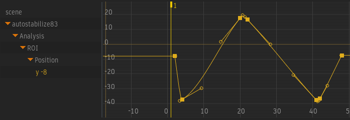

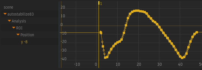

For example, the following figure shows an animation curve created using the Stabilizer. Simplify is applied with a value of 20. In sections where the slope of the curve is fairly constant in one direction, keyframes are removed between the peaks and valleys. You can adjust the simplified animation curve more easily because there are fewer keyframes to modify.
The Y curve before applying Simplify has a keyframe at each frame  
The Y curve after applying Simplify with a simplification value of 20.  
