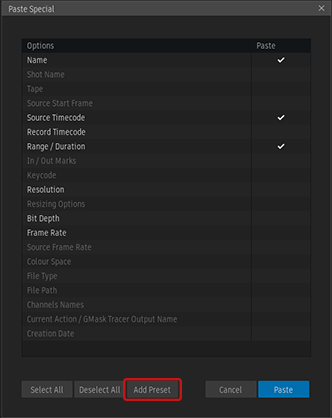

Paste Special Presets
You can now save a Paste Special preset in the Paste Special custom window.
- An added preset is available in a node's context menu.
- To delete a Paste Special preset, open the Paste Special window, and then select Preset drop-down menu
Delete Selected Preset.

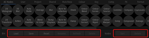

Easier to understand bin buttons. The buttons at the bottom of the Node bins are now organized into two sections: Bin and Nodes. This make is easier to understand what each button does.
Deleting nodes and bins. The Delete bin button can delete any bin, except for All Nodes, Project, User, Shared, Matchbox, and Lightbox. The Delete node button cannot be used to delete nodes in the following bins: All nodes, Matchbox, and Lightbox.
