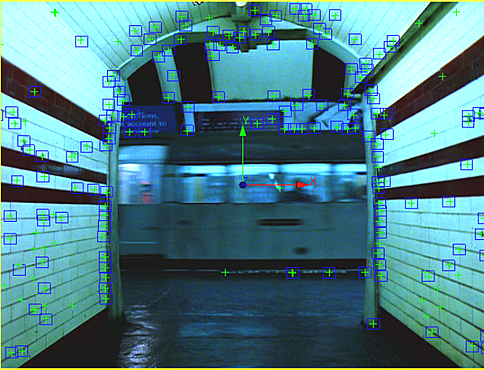

    After tracking has completed and you press Confirm, the Analyze button changes to Update, and you can see the 2D tracks (the blue squares in the following example) and 3D points (green crosses) in your image, provided that you are in Analyzer 3D view.
    Image courtesy of Behavior Communications Inc.

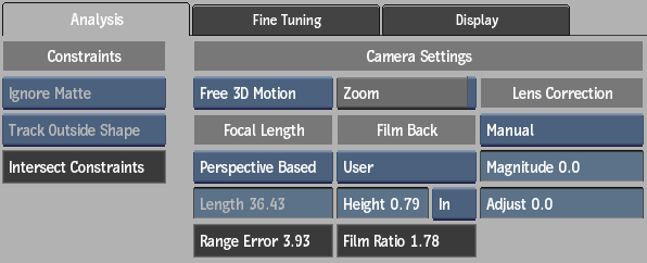

  1. With the Analyzer object selected in the schematic, select the Analyzer 3D view from the View box.

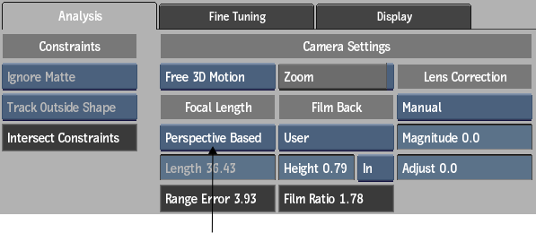

  2. From the Analysis tab in the Analyzer, select Perspective Based from the Focal Length box.
    A perspective grid appears in the view with the selected media.
  3. While in Analyzer 3D view, drag each of the four corners of the rectangle to the desired location to form a rectangular grid. The rectangle automatically aligns to the new perspective. The Range Error, which displays the error estimate for the focal length, should be small relative to the focal length (should be less than 10% of the focal length). When dragging one of the corner points of the rectangle, if your desired location cannot be computed (for example, if a point goes past another point on the plane), the location is remembered with a dotted line and red circle. Once you move other corners, your original location may now become viable, and the rectangle and grid align properly. (See Perspective Grid for details on placing the corner points.)
