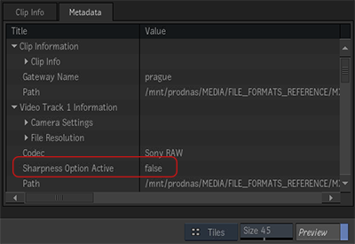

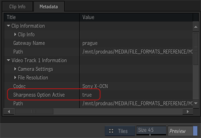

Sharpness is not supported by older SonyRAW media files, such as files generated by Sony F65 cameras. Look at MediaHub Preview Metadata Sharpness Option Active. Sharpness affects the media only if it says True.
Sharpness has an effectSharpness has no effect
