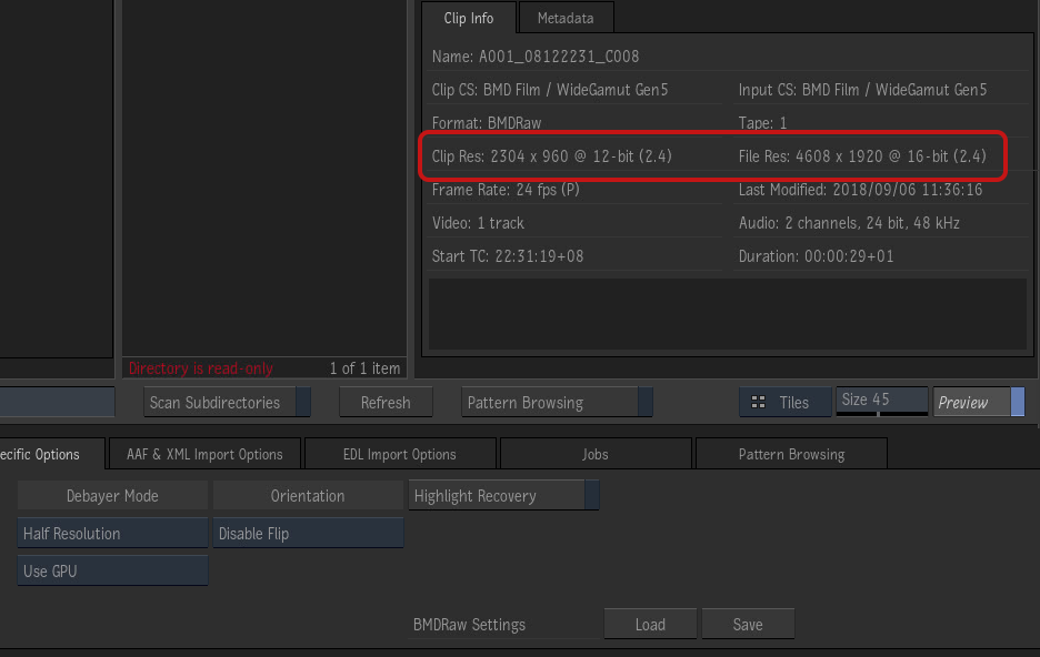

File Resolution Information
The Preview panel now displays the clip and file resolution of any media file you select in MediaHub.
The clip resolution differs from the file resolution because this .braw file is debayered at half resolution.
FieldInformation
Cip ResolutionThe actual resolution of the clip, based on Resolution and codec specific Format Options Debayering options. This is the resolution you get once the media is imported in the application.
This information is also available in the MediaHub List view under Resolution.
File ResolutionThe actual resolution of the media file.

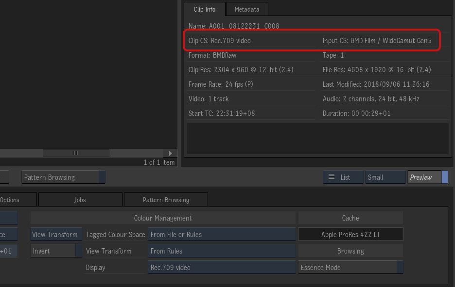

Colour Management Information
The colour management information is presented in the Preview panel now mirrors the order in which resolution information is presented: clip colour space is in the left column, file colour space in the right one.
This information is also available in the MediaHub List view.
Based on the Colour Management options, this .braw file read with a colour space BMD Film/Wide Gamut Gen 5 is imported with a Rec. 709 view transform.
Preview panel FieldList View HeadingInformation
Cip CSClip Colour SpaceColour space applied to the clip, based on MediaHub Colour Management.
Input CSInput Colour SpaceThe information displayed depends on MediaHub Colour Management.
  • From File or Rules: Displays the colour space used as the input for the colour management rules. In this case the information displayed is identical to that displayed in the File Colour Space column.
  • User-selected colour space: Displays the colour space you have selected in the Colour Management options.
 File Colour SpaceThe original colour space of the selected media file, as read from the file metadata.

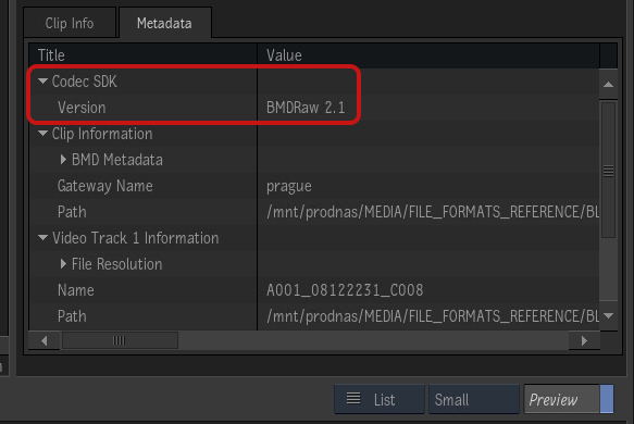

Format SDK Information
Camera makers are responsible for providing the tools required to decode the media output by their cameras. These tools are called Software Developer Kits (SDK). Flame uses these SDK to read and process these media files.
And as makers update and release new cameras, they release new versions of their respective SDK. The Preview panel can now display what version of an SDK is used to decode the media file in the Metadata tab.
The following formats use an SDK:
  • ARRIRAW
  • Blackmagic Design RAW
  • OpenEXR
  • R3D
  • Sony RAW
