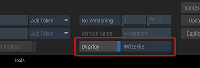

To burn Metadata Overlay on a clip exported from Write File node:
  1. In the Write File node, enable Overlay.
  2. Select the source of the metadata to burn. Choose between the Write File itself or any one of the ten Context views. The Result (F4) view displays the information from the option that you selected in the drop-down button—Write File or Context view.

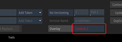

    If the selected Context has no Metadata Overlay applied, then the Write File node Result view displays nothing. The name of the Context view appears in red in the drop-down button.
To use a Context view as the source for the Metadata Overlay, you must enable Metadata Overlay on that Context.
To assign a metadata overlay to a Context:
  1. In a viewport, display a Context.
  2. Click Metadata Overlay, and select an overlay preset.
    You can now use the displayed information as the source for the overlay burn by the Write File node.

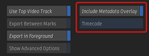

Metadata Overlay for Export
The Metadata Overlay can be burned into the image during an export. The option is available for File Sequence and Movie, but not for Sequence Publish.
To burn the Metadata Overlay on export:
  1. In the Media Export window, select Include Metadata Overlay .
  2. From the Metadata Overlay Selection box, select the overlay to burn on the exported media.
Note: If you save an export preset, the status of Metadata Overlay is included in the export preset.
