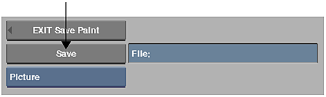

Use the crop box to limit the area of the picture, matte, cutout, or paint graphics to be saved in the setups directory.
To save a cropped matte, image, or cutout:
  1. In the Paint menu, click Save.
  2. Click Picture, Matte, or CutOut to specify the element from the image you want to save.
  3. Draw the crop box on the canvas by pressing and dragging the cursor diagonally across the screen. Alternatively, use the left, right, top, and bottom Crop fields to set the boundaries of the crop box.
    Note: Click Reset to reset the crop box values.
  4. Click Save.
  5. Select the item you are saving from the option box and name the setup in the keyboard display.
    If you want to overwrite an existing setup, select the filename from the file browser.
  6. Press Save (Enter) to save the setup.
