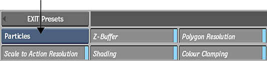

  2. From the Preset Type box, select Particles.

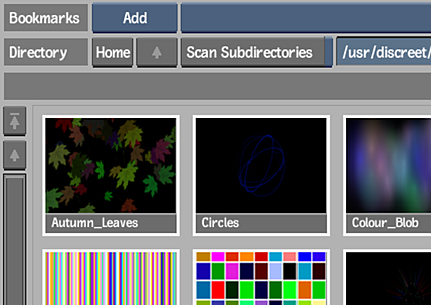

    The Particle Preset file browser appears, pointing to the default location of the presets: opt/Autodesk//particle_presets.
  3. Optional: Enable Scale to Action Resolution to load the preset in the current Action resolution.
  4. Optional: Select which rendering settings to enable or disable in the preset (Z-Buffer, Shading, Polygon Resolution, and Colour Clamping).
    Note: These settings are enabled by default, and by disabling any of them, you may not see the intended results in the preset.
  5. Navigate through the subfolders to select the particle preset you want to load. Hold Ctrl and click to select multiple presets.
    Tip: Switch to Proxies view to see a visual representation of the presets.
  6. Click Load.
    The particle preset is then appended to your Action scene.
