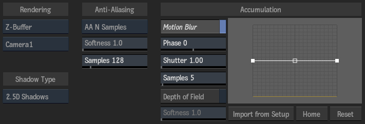

Rendering Settings
Z-Buffer Mode box
Select an option to determine whether the distance from the camera eye is considered.
Select:To:
Z-BufferArrange sources according to their distance from the camera eye.
Z-Buffer OffNot consider the distance from the camera eye when arranging sources.
Shadow MixTo render each shadow in the correct Z order with its corresponding source.
Camera Selector box
Select the child camera under a parent source node.
Shadow Type Settings
Source Shadow Type box
Select the type of shadow cast for the source node. This setting is available in the Shadow Cast menu only if the shadow cast node is a child of a source node, and is repeated in the Source menu.
Anti-Aliasing Settings
Anti-Aliasing Sample box
Select a software anti-aliasing sampling level. To set an arbitrary amount of animatable samples, select AA N Samples, then choose the number of samples in the Samples field that appears.
Softness field
Displays the softness of the anti-aliasing sample. Editable.
Samples field
Available when AA N Samples is selected in the Anti-Aliasing Sample box. Displays the number of anti-aliasing samples to consider. Editable and animatable.
Accumulation Settings
Motion Blur button
Enable to use a motion blur effect for the selected source node (can only be used if the global Motion Blur is enabled in the Action Setup menu).
Phase field
Displays the frame that motion blur is based on (before or after the current frame). Editable.
Shutter field
Displays the duration of motion blur at each frame. Editable.
Samples field
Displays the quality level of motion blur and the depth of field produced by the number of samples taken at each frame. Editable.
Increasing the number of samples causes the processing time to increase linearly. The number of motion blur samples is multiplied by the number of anti-aliasing samples. To reduce the total number of passes made for each frame, reduce the level of anti-aliasing when Motion Blur is enabled.
Tip: You can animate the Motion Blur button, as well as the Phase, Shutter, and Samples fields in the Channel Editor under the source > motion_blur folder.
Depth of Field button
Enable to use the camera's depth of field.
Softness field
Displays the softness of the depth of field. A low value yields a sharp falloff between focused and unfocused regions. Editable
Motion Blur Curve
Displays the sample weight over the scope of the motion blur.
Import from Setup button
Click to use the anti-aliasing and motion blur values from the Setup menu.
Home button
Resets the curve viewer to show the whole curve.
Reset button
Resets the anti-aliasing and motion blur settings to their default values.
