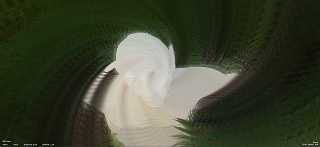

Use Recursive Ops to perform a wide range of recursive, animation-based blending effects. Recursive Ops uses the processed result of the previous frame and blends it with the current frame using a selected blending mode. It features a built-in colour selection, which constrains the accumulation effect within that selection. Additionally, it accepts an external matte input which also conditions the way in which the internal blending occurs.
