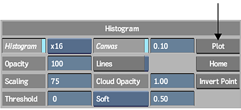

  6. Click Pref.
  7. In the Preferences menu, click Plot.
  8. Plot a grey pixel in the foreground subject by clicking it.
