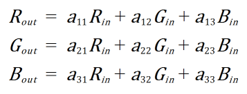

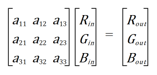

3×3 Matrix Multiplication

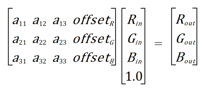

3×4 Matrix Multiplication

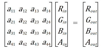

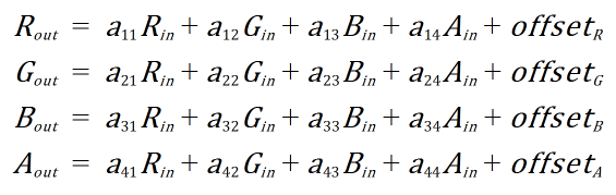

4×4 Matrix Multiplication

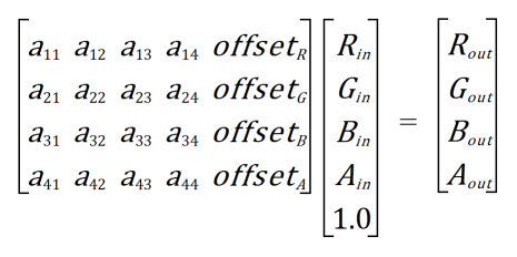

4×5 Matrix Multiplication
