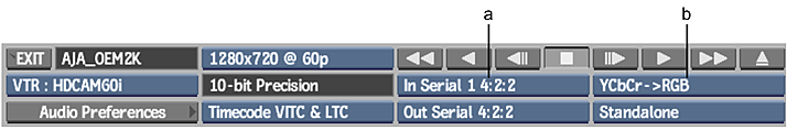

In the VTR Input module, click Engineering.
The Engineering menu appears.
(a) Input Connection box (b) Colour Space box
From the Input Connection box, select the input connection.
From the Colour Space box, select YCbCr->RGB+Headroom.
