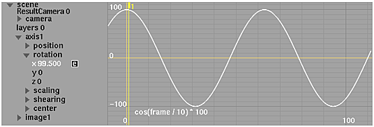

cos
Returns the cosine of a given angle.
| Syntax: | cos(Angle) |
| Arguments: |
| Examples: |

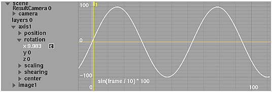

sin
Returns the sine of a given angle.
| Syntax: | sin(Angle) |
| Arguments: |
| Examples: |

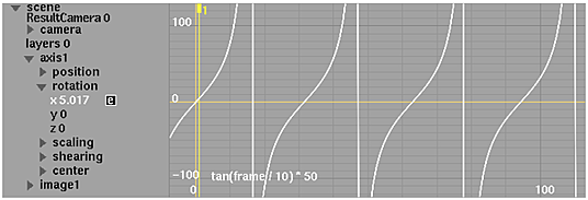

tan
Returns the tangent of a given angle.
