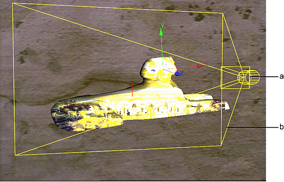

  5. Switch to Camera view to manipulate the projector in the scene using the View box.
    (a) Projector icon  (b) Yellow outline shows the projector field of view
