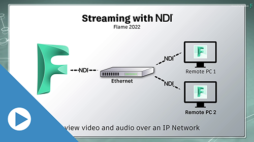

Streaming with NDI
With NDI, you can stream audio and video across a network. It's low-latency, and essentially behaves like video card, allowing you to broadcast the output across your network.

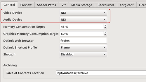

  1. Open Flame Setup.
  2. Open the General tab.
  3. Set Video Device and Audio Device to NDI.

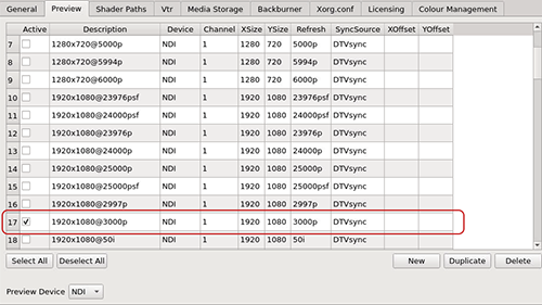

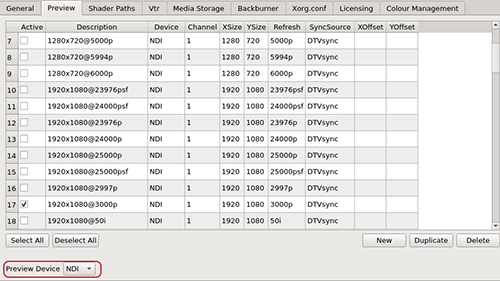

  4. Open the Preview menu.
  5. Set Preview Device to NDI to select it as you broadcast output.
  6. Select a timing and resolution for the broadcast output. The quality of your network should dictate your resolution and timing choices.
