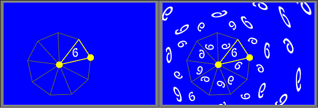

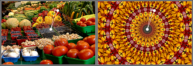

The radial symmetry mode displays a user-defined widget, which is a polygon with an equal number of sectors to the order of symmetry. You select the sector to use as the originating tile, the basis for a kaleidoscopic texture. Additional parameters allow you to define the center of symmetry of the image, and the angle and radius of the originating tile.
Front and Result views in radial symmetry mode

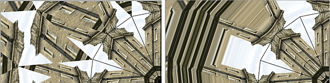

In Radial mode, you can also reuse the pixel on the edge of a sector to pad the space between outer tiles.
Result views with the repeating disabled and enabled

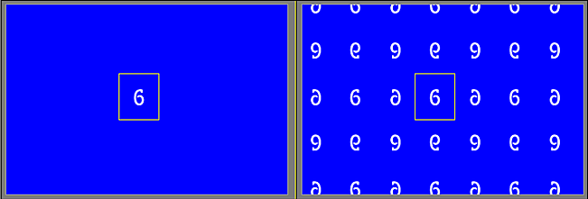

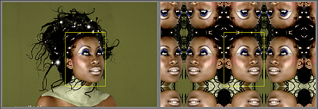

The region of interest (ROI) effect uses a user-defined rectangular or triangular selection as the originating tile to create a basic mirrored texture.
