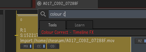

Just like you can add nodes in Batch and Action with Search, you can now use it to add Timeline FX and transitions in Conform, Timeline, and Effects.
You can add any Matchbox shaders, Sparks, Open FX plugins, and Pybox handlers available to your Flame. When adding a BFX, you select the flavor to add: Selection As Clip, Selection As Flowgraph, Selection as 3D Comp, or Add Adjustment Segment.
To display Search:
- From Conform, Timeline, Effects, and Batch or Action Schematic:
- Press Spacebar + TAB.
- Press F12.
- Click Ctrl + Pen Button 2.
- Select Search from the context menu.
- Select Search from the Flame menu.

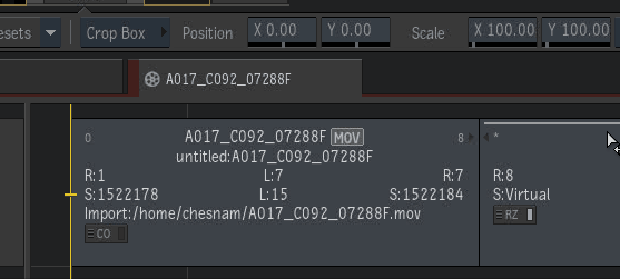

In a multi-selection, a red Timeline FX indicates that one or more of the selected segments carry that effect. In this case, Ctrl+click the segment (or segments) to remove them from the selection, and then Search again to add the Timeline FX.
