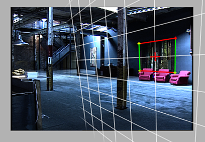

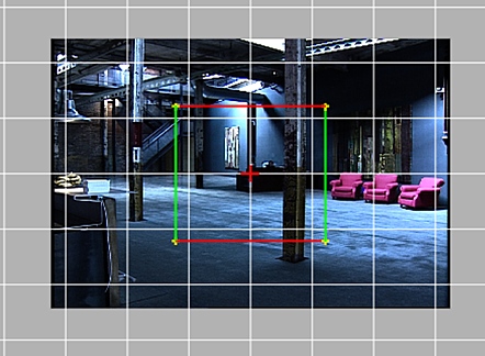

  4. With the Perspective Grid object selected in the schematic, select Action Object Solo view from the View box (or press F8) to see the grid and the selected media.
  5. From the Perspective Grid menu's Grid tab, select whether you want a 3D or 2D grid mode.
  6. While in Action Object Solo view, drag each of the four corners of the rectangle to the desired location. The grid automatically aligns to the new perspective.
    Tip: If the Magnifier button is active in the Display tab of the Perspective Grid menu, each corner is magnified as you drag it, helping you to find the exact location to place it.
  7. Set other Grid Settings, as needed.
  8. Once you are satisfied with the alignment of the perspective grid rectangle, parent an object to the Perspective Grid node. The object inherits the perspective transformation of the Perspective Grid node. Switch to Result view (F4) to see the complete scene.
