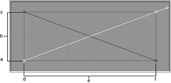

  3. To adjust the luminance curve for the front matte, select Front from the Matte box. To adjust the back matte curve, select Back. Alternatively, click a curve to select it.
    (a) 255 (White)  (b) Output (remapping of luminance values)  (c) 0 (Black)  (d) 0 (Black)  (e) Input (current luminance values)  (f) 255 (White)  
    In Select edit mode, click a point to display its tangent handle and drag the handle to adjust the curve. Use other modes in the Tools box (Add Points or Break Tangent, for example) to further adjust the curve, adding or deleting points, or breaking tangent handles as needed.
