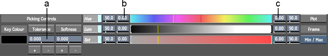

    The colour values that the colour picker samples are used to set the maximum and minimum values for the tolerance range. The white lines define the limits of the tolerance range. All colour values between the white lines are extracted from the key-in clip.
    (a) Master Tolerance field (b) Minimum Tolerance field  (c) Maximum Tolerance field  

To set the tolerance range using the numeric fields:
  1. Set the minimum value for the tolerance range using the Minimum Tolerance field on the left side of the colour bar.
  2. Set the maximum value for the tolerance range using the Maximum Tolerance field on the right side of the colour bar.
Note: You can also set the tolerance range by entering a numeric value in the Master Tolerance field.
