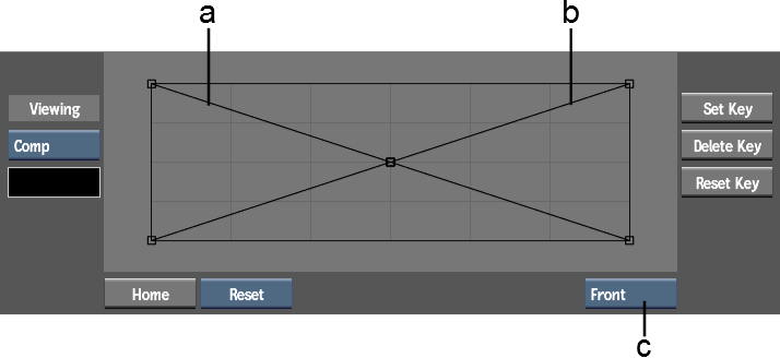

  1. Double-click the Result node in the schematic.
    The Luminance curve appears.
    (a) Front matte curve  (b) Back matte curve  (c) Front/Back box    
  2. Use the Viewing box to select the image you want to view as you adjust the curves.
    Select:To view:
    ResultThe composite clip.
    MatteThe front matte. You cannot see changes made to the back matte when this view is selected.
    BmatteThe back matte. You cannot see changes made to the front matte when this view is selected.
    CompThe composite with a coloured background. The default colour is black. To select a different colour, click the colour pot to the right of the Comp button. The colour picker appears.
    Key InThe image that was used to pull the key.
    BackThe background image that is revealed when the front is keyed.
    FrontThe image to which you applied the key.

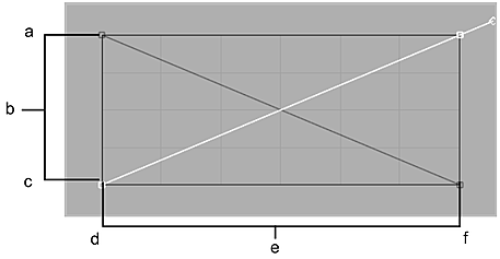

  3. To adjust the luminance curve for the front matte, select Front from the Front/Back box. To adjust the back matte curve, select Back. Alternatively, click a curve to select it.
    The selected curve changes to white.
    (a) 255 (White)  (b) Output (remapping of luminance values)  (c) 0 (Black)  (d) 0 (Black)  (e) Input (current luminance values)  (f) 255 (White)  
  4. Click a point to display its tangent handle and drag the handle to adjust the curve. Use other modes in the Tools box to further adjust the curve, adding or deleting points or breaking tangent handles, as needed.
