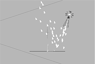

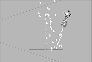

The greater the percentage, the more particles bounce straight. For example, in the left figure, Friction is set to 100%, which bounces particles almost perfectly straight. In the figure on the right, Friction is set to 20%, which causes the particles to deviate once they make contact (bounce).

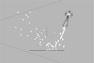

For example, at a Resilience of 100%, the figure on the left shows there is no energy lost between bounces. Each bounce is at the same height as the last bounce. When Resilience is set to 80%, 20% of energy is lost between each bounce. At 50%, the figure on the right shows the height of each bounce is reduced by 50%. Note that Friction is set to 0 for both examples.
