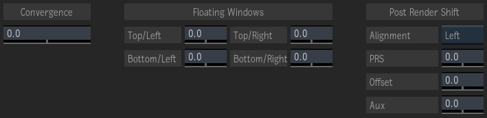

Stereo Toolbox Menu Settings
Convergence Settings
Convergence field
Set the initial horizontal offset between the left and the right eye. A higher convergence value results in a 3D scene with more depth along the Z-axis. A lower convergence value results in a 3D scene with less depth along the Z-axis. Editable.
Floating Windows Settings
Top/Left field
Affects the displacement value of the Top/Left corner of the Floating Window. Increasing the value results in the Floating Windows's Top/Left corner being "pushed out" away from the viewer. Decreasing the value results in the Floating Window's Top/Left corner being "pulled in" towards the viewer. Editable.
Bottom/Left field
Affects the displacement value of the Bottom/Left corner of the Floating Window. Increasing the value results in the Floating Windows's Bottom/Left corner being "pushed out", away from the viewer. Decreasing the value results in the Floating Window's Bottom/Left corner being "pulled in", towards the viewer. Editable.
Top/Right field
Affects the displacement value of the Top/Right corner of the Floating Window. Increasing the value results in the Floating Windows's Top/Right corner being "pushed out", away from the viewer. Decreasing the value results in the Floating Window's Top/Top Right corner being "pulled in", towards the viewer. Editable.
Bottom/Right field
Affects the displacement value of the Bottom/Right corner of the Floating Window. Increasing the value results in the Floating Windows's Bottom/Right corner being "pushed out", away from the viewer. Decreasing the value results in the Floating Window's Bottom/Right corner being "pulled in", towards the viewer. Editable.
Post Render Shift Settings
Alignment box
Select whether the offsets affect the Left, Right, or both eyes (Centre).
PRS field
Affects the horizontal translation offset value applied between the two shots in the scene. This parameter is relative to the setting if the Alignment box. Editable.
Offset field
Aux field
