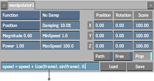

Select Function to specify your own mathematical expressions to be used as a particle manipulator. You can use the channels from the Particle Manipulator and Particle Generator menus in your expressions, as well as arithmetic operations, mathematical conventions, functions, and constants.
(a) Expression field  

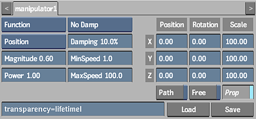

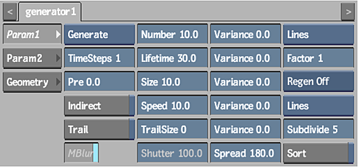

Making Particles Transparent

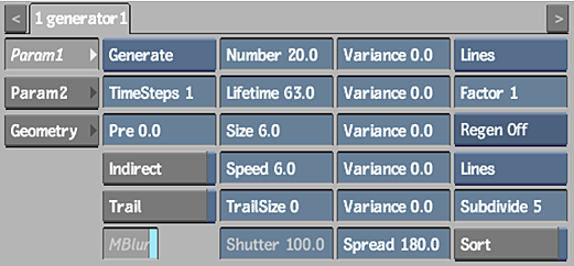

The following example illustrates how to make particles become transparent as they reach the end of their lifetime using the expression transparency = lifetimeI. The settings in the Particle Manipulator menu, Particle Generator menu, and the resulting effect are shown.

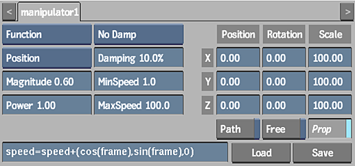

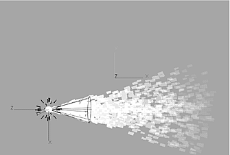

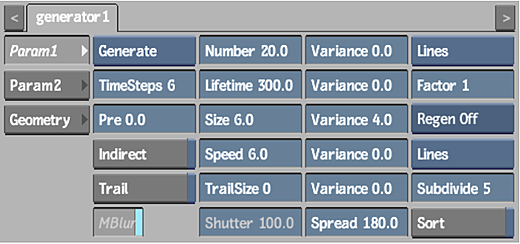

Making Particles Spin
The following example illustrates how to spin particles using the expression:
speed = speed + (cos(frame),sin(frame),0)
The settings in the Particle Manipulator menu, Particle Generator menu, and the resulting effect are shown. Notice that the particle Timestep value is increased to improve the accuracy of the particle stream.

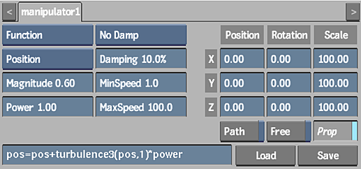

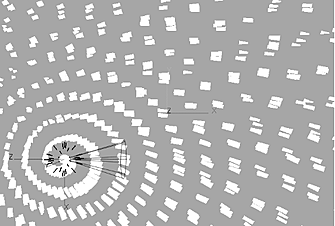

The following example illustrates how to create animated turbulence using the expression:
pos = pos + turbulence3(pos, 1) * power
