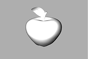

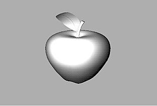

    A high Shine value produces a dimmer highlight while a low Shine value produces an intense highlight. When the Shine field is set to zero, the 3D model does not have a highlight. The following example shows the same 3D model using two different Shine values.
    Shine is set to 1. The specular highlight is intense.
    Shine is set to 20. The specular highlight is dimmer.
