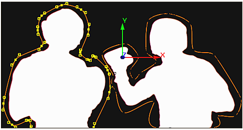

In GMask Timeline FX, and the GMask node in Batch or Batch FX and the Modular Keyer, you can use a parameter called Region of Interest (ROI) when drawing multiple garbage masks on a clip to remove the portion of the matte that falls outside of each mask while respecting the area defined by all masks.
ROI enables you to reveal multiple parts of the matte.

In the GMask node in Batch or Batch FX and the Modular Keyer,you also have the option of using the Tracer with an advanced gradient. The Tracer is an additional softness tool you can use to pull a key from scratch. This allows you to key images with a lot of detail at the edges. It uses a system of localized keys, called pickers, which analyse the colour information both inside and outside the mask to derive a key for the mask edge. You can use both the Tracer and the advanced gradient within the same garbage mask.
