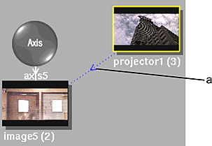

    • To project only a selected surface, drag a connection from the Projector node to one or several nodes in your scene. A selective projection connection is represented by a blue dotted line.
      Once a selective connection is created, the projector only affects the object to which it is connected.
    (a) Inclusive projection connection  
