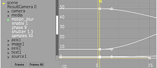

To use motion blur, enable the Motion Blur button in the Action Setup menu and specify motion blur settings.
You can animate the Motion blur button, as well as the Phase, Shutter, and Samples fields. They can be found in the Channel Editor under the motion_blur folder.
