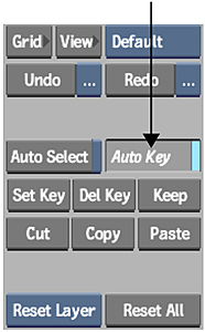

Use Auto Key to create keyframes automatically as you make changes to text attributes. The movement between keyframes is interpolated according to the interpolation mode you set.

  1. In the Text Animation menu, enable Auto Key.
