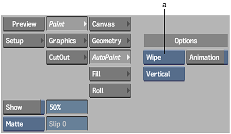

To display the AutoPaint controls:
  1. Click AutoPaint in the Paint menu. If the controls are hidden by the colour palette, swipe the bottom of the screen.
    (a) Autopaint Mode box
The AutoPaint Mode options are described as follows.
User
Records and plays back a series of manual paint strokes.
Random
Applies a number of random strokes to the image.
Wipe
Wipes the entire canvas with the current colour or medium.
