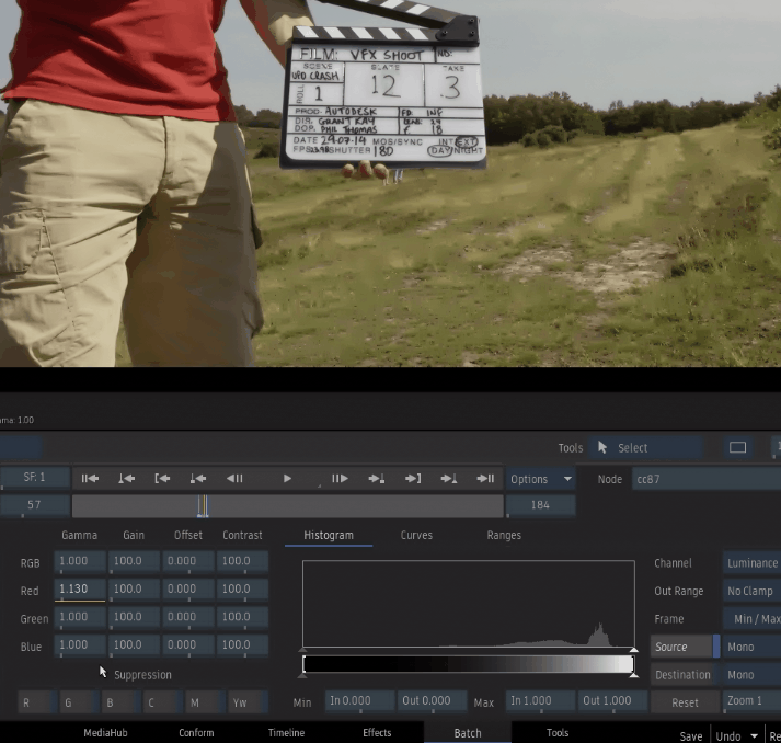

The Animation Channel Editor offers more control over your animation than is offered when editing the values of parameters in an effect or node editor. Use the Animation Channel Editor to fine-tune changes across all animation channels available for the effect or tool you are working on.
To display the Channel Editor:
Click Animation.
The Animation Channel Editor is displayed in the bottom area of the window.
