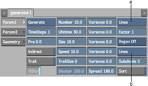

  2. In the schematic, double-click the Particle Generator node to access the Generator menu.
    (a) Interactive Type box  (b) Render Type box  
  3. From the Render Type box, select Node as the particle type and change the Interactive Type box to Node to view the 3D object or text as you make changes to your particle stream.

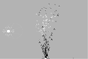

    The particle generator uses the 3D object or text named ParticleDraw. The following figure shows the schematic and the result of using the letter A as a custom particle and a light source as the particle generator.

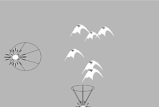

    The following figure shows the schematic and the result of using an extended bicubic surface as a custom particle and a light source as the particle generator. The shape of the surface is animated and its axis is used to rotate the particles.
Note: You can animate the shape of a bilinear, perspective, or extended bicubic surface, and have the particles reflect the animation.
