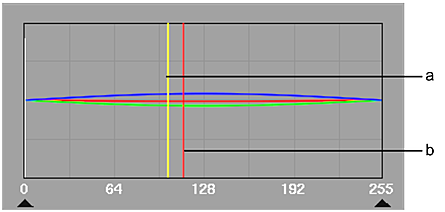

Samples appear in the histograms. In the 2D luma histogram, the Plot sample is represented by a red bar and the Ref sample is represented by a yellow bar.
(a) Reference colour (yellow vertical line)  (b) Plotted colour (red vertical line)  

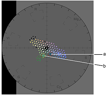

In the vectorscope, the Plot sample is outlined in red and the Ref sample is outlined in yellow.
(a) Plotted colour (outlined in red)  (b) Reference colour (outlined in yellow)  
