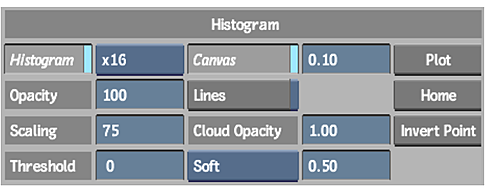

Change other display elements of the histogram using the Preferences menu. To access the Preferences menu, click Pref.
Histogram
Enable to show or hide the histogram. Alternatively, use the H keyboard shortcut.
Histogram grid
Enable to displays the resolution for the cubes:
  • x16 (the default)
  • x8 displays fewer and larger cubes
  • x32 displays smaller cubes
Opacity field
Displays the opacity of the cubes. As you adjust the opacity, smaller cubes become transparent at a faster rate than larger ones. The default setting is 100% opacity.
Scaling field
Resizes the cubes. Cubes representing less prevalent colours (the smaller cubes) are scaled down more than those representing more prevalent colours. The cube of the most prevalent colour remains the same size (as set in the Histogram Grid box). By increasing the size difference between the colours of greater and lesser prevalence, you can see the main components of the colour space more clearly.
Threshold field
Removes the display of colours that are less prevalent in the image. As you increase the threshold, less prevalent colours are increasingly removed from the histogram.

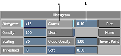

Setting the Canvas Display
The canvas is the black background of the RGB viewer. Control the display of the canvas using the Preferences menu.
(a) Canvas button  (b) Canvas Light field  
Canvas button
Enable to show or hide the canvas. Alternatively, use the C keyboard shortcut.
Canvas Light field
Displays the amount of lighting in the RGB viewer. The light source emanates from behind the viewer.
