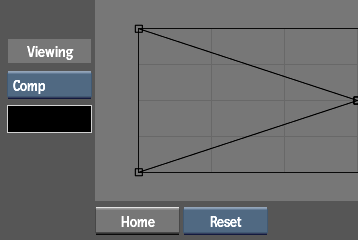

  1. Double-click the Result node.
    The Matte Luminance Curves menu appears.
  2. In the Result box, select Comp.
    A colour pot appears.
  3. Click the colour pot under the Comp view output option.
    The colour picker appears.
  4. Select a colour for the background using the colour picker.
    Your key is displayed on a solid colour background in the Result view.
