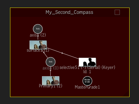

Adding the Compass node to the schematic creates a box that you can resize and place over the nodes you want it to encompass. The nodes in the Compass are automatically selected when you click on the Compass header, and all the nodes included in the Compass will follow when you move the Compass. The Compass node makes it easier to manage your Action schematic and scene, particularly if it is very large.

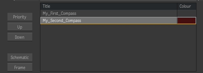

The Compass menu, which appears when a Compass node is selected in the schematic, contains a table that enables you to sort the different compasses in Z space, using the Up and Down buttons. You can also assign a colour to each Compass object in the schematic. The default colour is grey.

You can rename a Compass node by clicking on the selected item name within the Compass menu table.

Compass nodes can be resized by selecting a corner or an edge of the box and dragging to the desired size.

- By clicking the colour pot on the right side of the Compass title header. This displays the Colour Picker for colour selection.
- By clicking the colour pot to the right of each item in the Compass menu table. This displays the Colour Picker for colour selection.

You can frame a Compass to the center of the schematic by selecting it in the Compass menu table and clicking the Frame button, on the bottom left. This is also achieved by double-clicking a Compass node entry in the Compass menu table.
