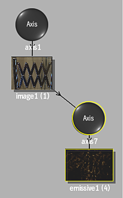

In the schematic, select the surface or 3D geometry to which you want to apply the emissive.
Click Media.
In the Media menu, select the media you want to use for the emissive.
Do one of the following:
- Drag the Emissive Map node from the node bin and place it in the schematic.
- Drag the Emissive Map node from the node bin and place it where you want it in Result view.
- Double-click the Emissive Map node. You do not need to be in Schematic view to add a node in this manner.
The emissive object is added to the schematic with its own parent axis. The new axis is the child of the selected surface or geometry. In Schematic view, the number in brackets next to the name of the Emissive node indicates the media used for the emission.
To specify different media as the source, select the media in the Media menu, then click Apply, or use the Read File tab to manage the texture media (see Working With Textures in Map Nodes).
