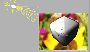

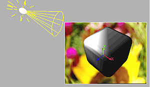

Use the Shine field to change the intensity of the specular highlight. When the Shine value is set to 0, the specular highlight is disabled. To change the size of the specular highlight, use the Falloff field in the Light menu.
This surface is lit using a Falloff of 30 and a Spread of 27. The surface's Shine is set to 10.
This surface is lit using a Falloff of 20 and a Spread of 27. The surface's Shine is set to 1.
