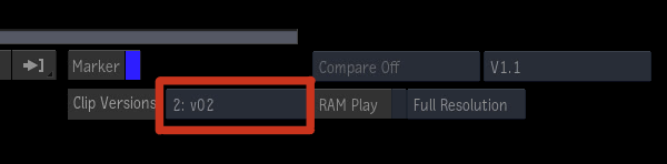

Version Selection from the Full Screen Player
When working with multi-versions content from Open Clips or Pattern Browsing, the Version Selection box now displays current version the segment in the full screen Player.
You can also use the Version Selection box to change the version displayed.
Note: When you go in the full screen Player, you can only change the version of the currently displayed segment.

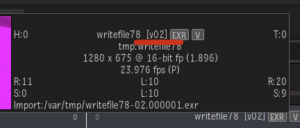

Timeline Segment Clip Version
The current version of a timeline segment is now displayed on the Timeline segment, and when you Alt+click a segment.
Timeline Segment displayAlt+Click Segment
