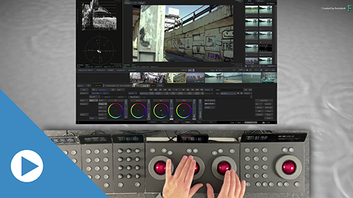

Grading with the Tangent ARC Panels—Credit: Tony Richards

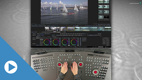

Grading with the Tangent Element Panels—Credit: Tony Richards
