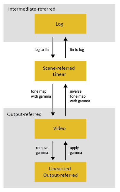

Manually Converting Between Working Spaces
Here are some notes that may be useful if you need to convert between working spaces by manually specifying custom chains of transforms from the collection:
  • You can convert scene-linear to video by applying a tone map such as PhotoMap_gamma_2.4 in the tone-map/ directory. In general, a tone map uses an S-shaped curve to increase the contrast and compress highlights.
  • You can convert video to scene-linear by applying an inverse tone map such as inversePhotoMap_gamma_2.4 in the tone-map/ directory. This will not be exact if the footage was originally shot as video or converted with a different tone map, but it can be a good approximation that works well in many cases. In particular, note that simply removing the display gamma from video images produces linearized output-referred values rather than scene-linear values - there are no values above 1.0.
    Note: There are special considerations for images that are used as textures and other maps. See Color Managing Textures and Maps.
  • You can convert scene-linear images to log space using one of the Lin_to_Log transforms in the film/LogLin/ directory.
  • You can convert log images to scene-linear using one of the Log_to_Lin transforms in the film/LogLin/ directory.
  • You can convert video images to log space by first converting to scene-linear and then to log.
  • You can convert log images to video space by first converting to scene-linear and then to video.
