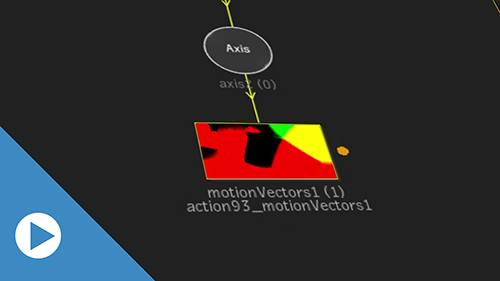

When you cache a Motion Vector map, the following happens:
- An orange dot appears next to the map.

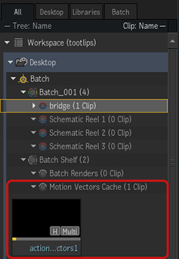

- A clip is created in:
The map is cached in a Batch Group: The clip appears in the Batch Shelf Motion Vectors Cache.
The map is cached in a BFX: The clip appears in a the library Motion Vectors Cache, in a folder named after the clip and the timeline segment.

- Double-click the orange dot next to the map.

In a the Schematic a Motion Vectors map displays the name of the cache clip below its object name.
