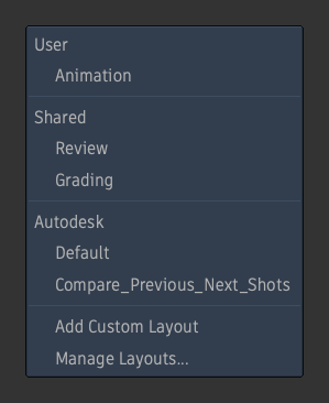

Presets can be saved under three different categories: User, Project, and Shared. Some tools also come with factory presets under the Autodesk category. These categories appear in the drop-down or file browser where presets can be saved and loaded.
  • User: Presets only visible to the current user.
  • Project: Presets only visible in the current project.
  • Shared: Presets visible to all users working on any project on a workstation. These presets can also be centralised for all workstations on the same network.
  • Autodesk: Factory presets read from /opt/Autodesk/presets/<version>/. These presets are installed with the application.
Note: Not all tools can save presets in all categories or have factory presets.

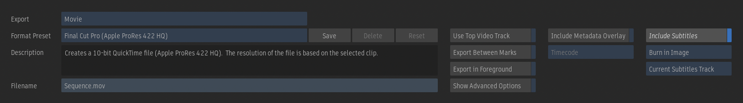

  1. Set the Media Export settings to the desired state. In the image below, Include Subtitles is enabled and the Burn in Image option is selected for a Movie File export.

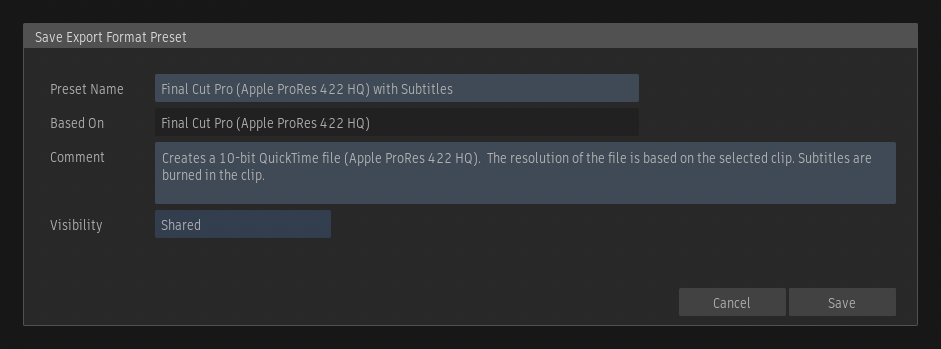

  2. Save the Media Export Preset to the Shared location.

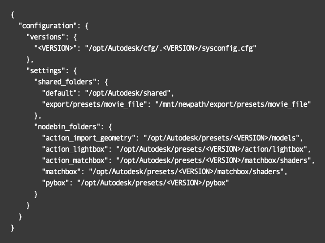

  4. Set a different location for the 'export/presets/movie_file' directory in the sysconfig.cfg file of multiple workstations.

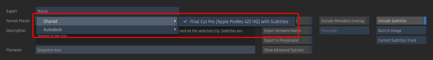

  5. After the application is restarted, the preset appears in the Shared category of the Format Preset drop-down button for all workstations.
