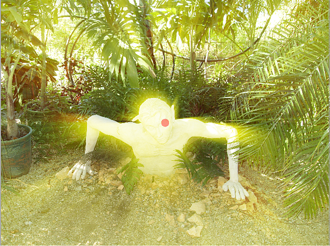

Glow
Use Glow to create and customize a glow effect on a clip.
